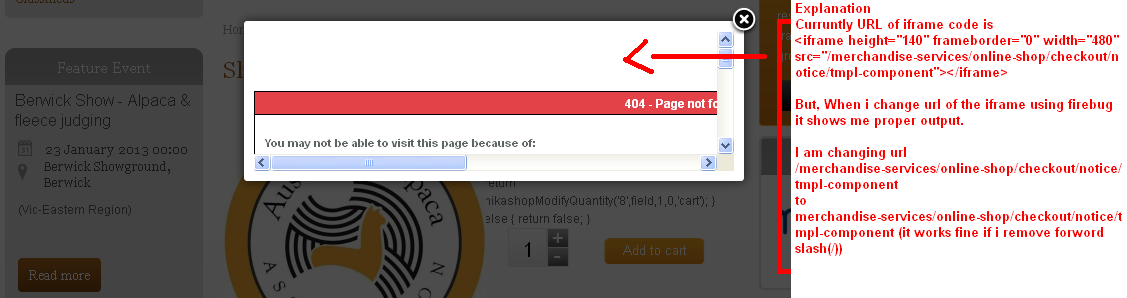

Let me explain visually.
Here i attached image. kindly check that image.
Last edit: 12 years 1 month ago by Hariyani.
