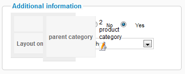

I tried looking for a solution online but could not find one, Please see print screen of my issue:
I get this on nearly all headings.... Anyway to fix it?

Do you have changed something in the backend templates ?
Are you using a custom template and not a default one for the backend ?
Try to install HikaShop again over your old HikaShop.

Hi, I install it on fresh installation and it gives the same issue,
Also the one I have installed it now has a custom template but it should not affect the backend.
If I reinstall it, will i lose my categories and items and settings?

Actually sorry, my mistake I am using VTEM admin template and that is causing the issue, Do you help sort this out?
12 years 1 month ago #85653
Are the other components working fine with this template ?
Your template is overriding our views and broke the headings.

Well all other components, ( over 8 + ) work perfectly fine, but its just your component which has the layout broken,
Can you guys help me out or do i need to contact the template owner? If you guys can help. It would be great.

Hi there,
If the template is overing our view the only solution you have is to find the broken css in your backend.
Try to take a look at the css with a right click and your browser's inspect element function.
You must find some css rules which are override, adding some new css in your backend css file will then do the job.
If you have found these broken rules, you can also edit them like this (example):
float:left;
to this
float:left !important:
It will give the priority to our css code.
