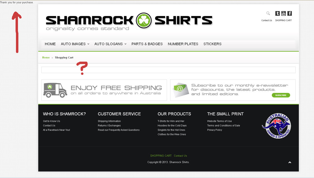

I have adjusted my php notice settings, so the notice line is no longer showing, however there is definately a problem.
As you can see from the screenshot attached, when a customer has gone through checkout (using the credit card, or paypal payment pro method) they are presented with a blank screen.
The "Thank you for your purchase" text is up in the top left corner of the screen, and there is nothing in the space where it should be. My customers are going to assume their order didn't work, this is going to cause great confusion.
My site is now LIVE so I need to fix this urgently. Your help would be appreciated.

That's not an error of HikaShop. That "thank you" message is displayed through Joomla/your template. And it's actually your template which is made to display messages there without any styling.
Usually, templates display messages in the middle of the page with some styling like on our contact page for example:
www.hikashop.com/en/support/contact-us.html
So the problem is actually that the template is missing the CSS for messages and that the position of messages should be in the middle. You should contact your template provider for that.
As a quick work around, you can edit the file "after_end" for your template via the menu Display->Views of HikaShop and instead of the code:
$app->enqueueMessage( JText::_('THANK_YOU_FOR_PURCHASE') );
you can use:
echo JText::_('THANK_YOU_FOR_PURCHASE');

I tried replacing that code, and it had no effect.
I also don't understand why it's a problem with the template, when it's only with the one type of payment method that this happens. Surely if it was a css problem it would be consistent across all 3 payment methods? The other two methods display the message correctly.

It's only a problem with this payment method because the two other payment methods do not use that view file to display the thank you message. The direct deposit payment method uses the "end" file of the view "checkout" to display its message and it uses the text echo JText::_('THANK_YOU_FOR_PURCHASE'); instead of the other one which is used by the after_end view file. That's why it already works for it and not for the "after_end" view file that is used by the other payment method.
So, the method I already gave to circumvent the problem is the correct one. If you don't see any change, it highly likely that you're not editing the view file for the correct template. If you're editing the view file for another template than the one you're using on your frontend, you won't see any difference.

For PayPal Pro and the direct deposit you will have to use that code in the end.php file then:
$app =& JFactory::getApplication();
if($order->order_payment_method!='paypal'){
$app->redirect(' www.shamrockshirts.com.au/index.php/thanks ');
For the PayPal plugin, you will need to edit the after_end.php file and use that code:
