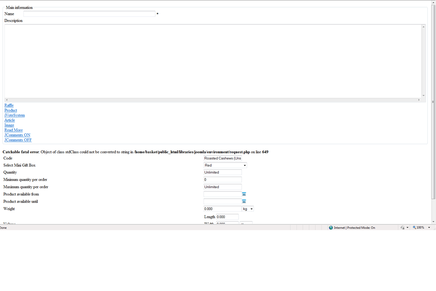

When I save in manage variant I get this error when I change the code field: Catchable fatal error: Object of class stdClass could not be converted to string in /home/basket/public_html/libraries/joomla/environment/request.php on line 649
Plus when I copy a product to use for a new one, the variants that were also copied will include a price that was not in the original copied product. In fact there was no price for the original copied variant.

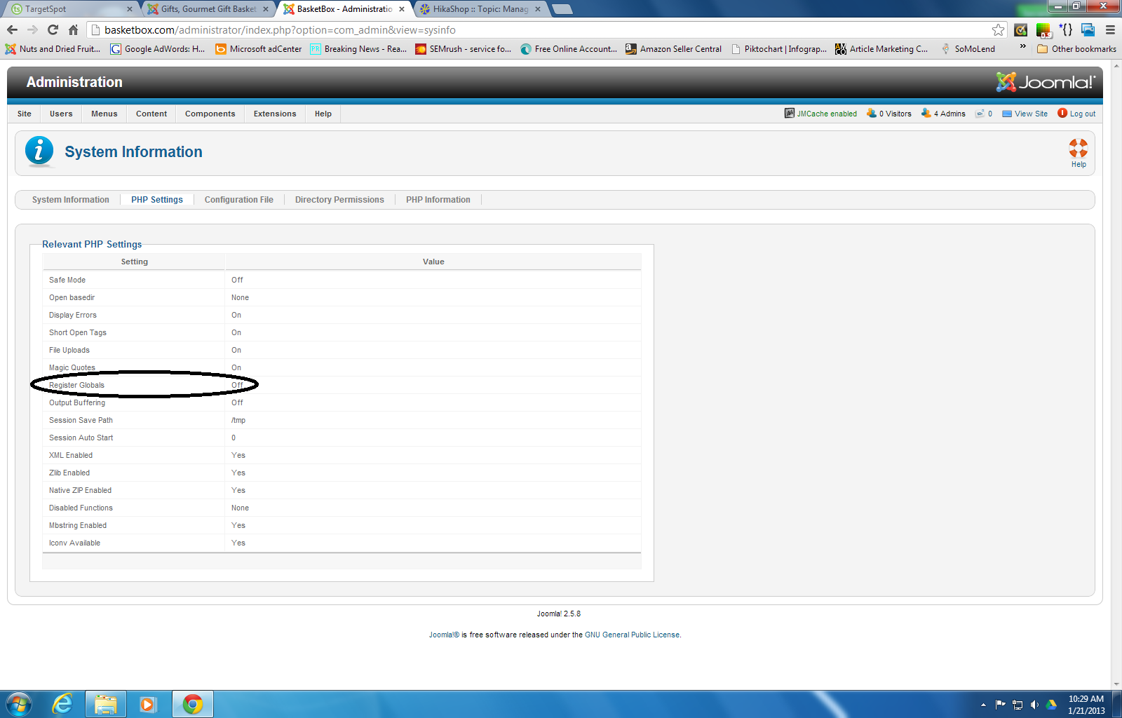

I think that you'll maybe find some solutions there :
I would say that this comes from the fact that you have the register globals option of your php turned on, which you shouldn't. Because of that, the option variable we use in our view overwrites the option variable that joomla uses on it end and thus you can that error.
Three solutions:
1. you change that line by:
$option = preg_replace('/[^A-Z0-9_\.-]/i', '', JRequest::getString('option'));
2. You edit the file option of the view product via the menu Display->Views and you change the variable $option by $optionElement to avoid the conflict.
3. You deactivate that php option, supposing that you have access to your php.ini
Hope this will help you.
  • Posts: 69
12 years 1 month ago #86425
Our register global is off. See screenshot. Any other solution?

Have not tried debug yet, but attached is a screenshot of what I get when I:
Go to a product
Click manage variants
Select variant
Remove code field old data and add new data
Select save and close
Then I get the error attached.
Last edit: 12 years 1 month ago by BasketBox.
