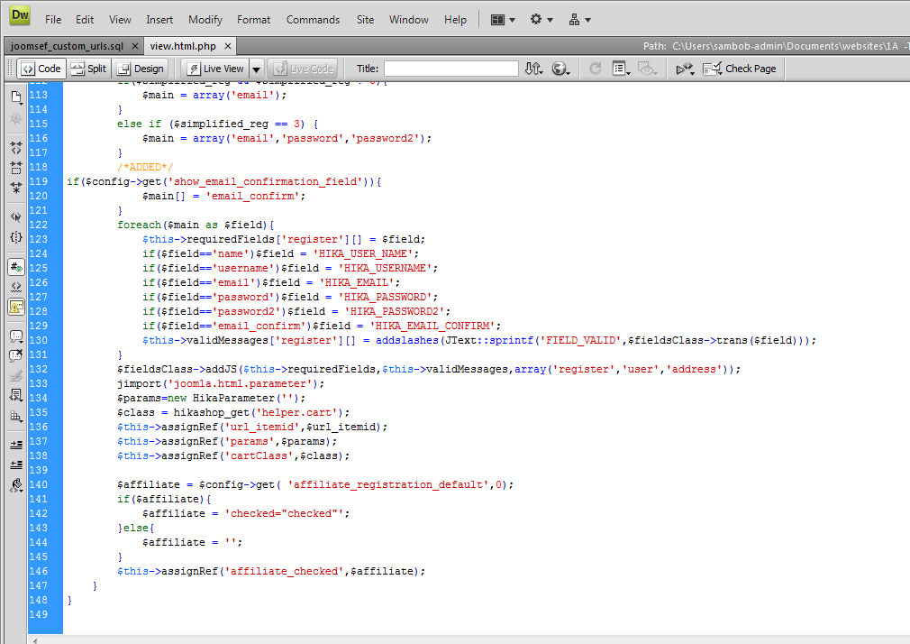

Can you do a screenshot of the whole piece of code so that we can check how you did the modification ?
  • Posts: 260
  • Thank you received: 25
11 years 11 months ago #88541
Here you go..
Don't look at what is and ask 'why?'; look at what isn't and ask 'Why Not!'
11 years 11 months ago #88782
You can take the latest version of HikaShop from our website, ands it should fix your problem.
