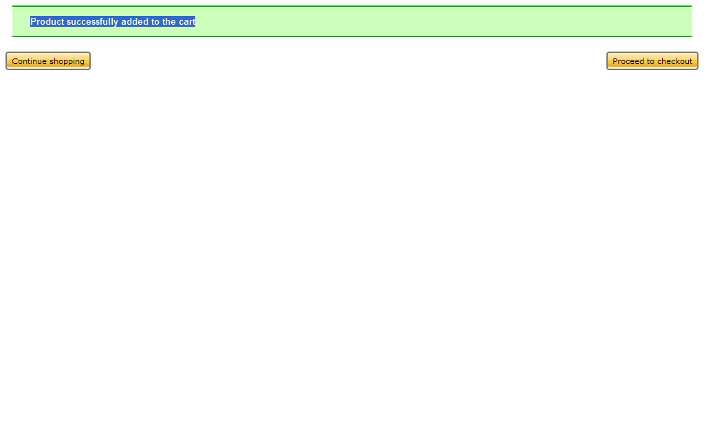

After updating to Hika 2.01 Im having 2 issues with the "Product successfully added to the cart" pop up window.
1 - After just a couple of seconds the frame brakes and the pop up expand to take up the whole page (see image)
2 - The "continue shopping" button wont work. I went to the setup and added a costume URL but still didnt work.
I searched your forum for a solution before posting but could not find any posting that would help me with this issue.

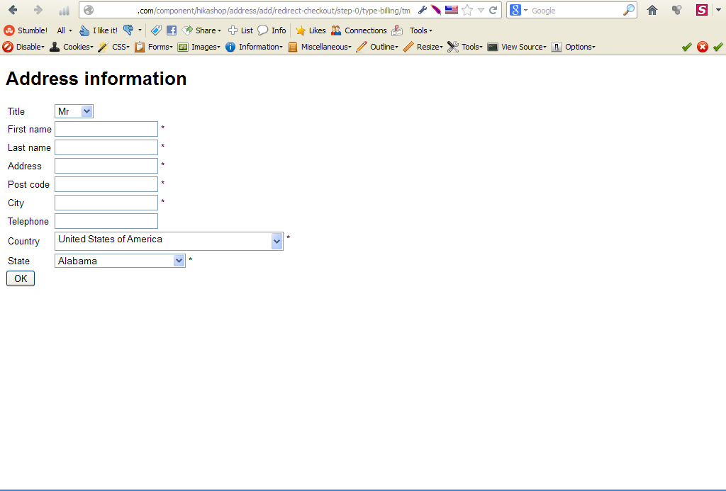

11 years 11 months ago #90478
I continue to have the same problem. Popups generated by hikashop brake the frame and take over the whole window. (see attached image). The problem in the enclosed image occurs when I click on the "New" button for costumers to add a new address in the check out process.
I really need help with this issue because it will drive costumers away once I open the shop.

11 years 11 months ago #90580
Do you use Joomla 3.0 ?
Did you activated the "use bootstrap design" in the HikaShop configuration ?
Does your template has mootools and "modal.js" libraries activated ?
HikaShop does not have his own popup system, we use the Joomla one.
So, if our popups does not show up correctly, it means that :
- The modal.js library is not included in your page.
- There is some javascript error in the page which make that the modal.js library is not initialized
- Some other possibilities with less probabilities.

11 years 11 months ago #90761
Hello Jerome, thanks for your help.
I'm using 2.5.9
Yes mootools and "modal.js" libraries are activated and called by the template. The modal.js is in the media/system folder and its the original one.
I do not think is a particular page because it has happen in different pages.
Still have the problem and still can not find a solution.
A test that I did was to load up a link to an image in one of the product text fields with the class "modal" and that works just fine without braking the frame..... so I feel it has to do with Hikashop

11 years 11 months ago #90942
Problem Solved.
If anyone is having the same issue of popup windows braking frames, my problem was the plugin "system anticopy". I had the "framing disallowed" option on......duh!
