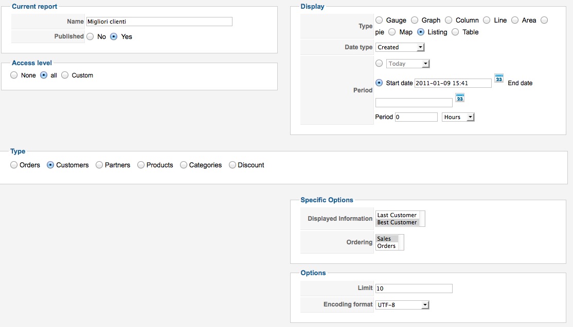

I prepared a report like the one in the attached figure.
the problem is that the total is added also reported also on the vendor
by the number of orders and for the total purchased
I do not think that is correct, how do I fix?
thanks
fabio

  • Posts: 89
11 years 11 months ago #89272
Yes, I try;-)
I configured a report as in the attached image.
This report shows data (number of orders and amount) incorrect
because they add up the values ​​of the vendors.
So for example, a customer has placed an order from € 100 associated with a seller. The report shows 2 orders with total € 200
I hope it is clear
Fabio

11 years 11 months ago #89553
Ok, now I get it.
That's a side effect of HikaMarket.
Add the line:
$filters[]=' o.order_type=\'sale\'';
after the line:
$filters[]=' a.user_id IS NOT NULL ';
in the file administrator/components/components/com_hikashop/classes/widget.php and that will fix it. It's added on our end for next version of HikaShop.
