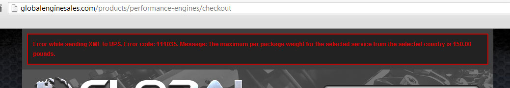

11 years 11 months ago #89554
Error while sending XML to UPS. Error code: 111035. Message: The maximum per package weight for the selected service from the selected country is 150.00 pounds.
i'm getting this with the ups shipping module. most of my products are over 150lbs there any way around this?

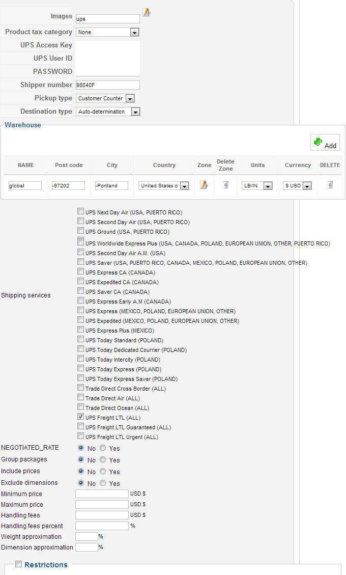

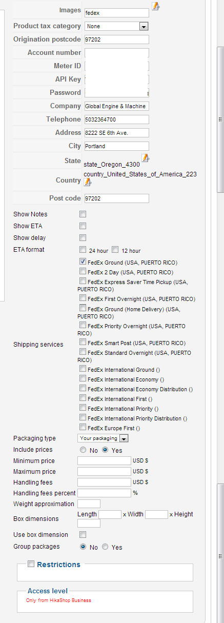

  • Posts: 36
11 years 11 months ago #89916
heres the ups and the fedex

  • Posts: 83159
  • Thank you received: 13433
11 years 11 months ago #90116
For the FedEx plugin, the configuration sounds ok.
For the UPS plugin however, you should remove the - at the beginning of the postcode. Otherwise, UPS will fail to interpret the post code properly. That probably explains why you don't get any rates with UPS.

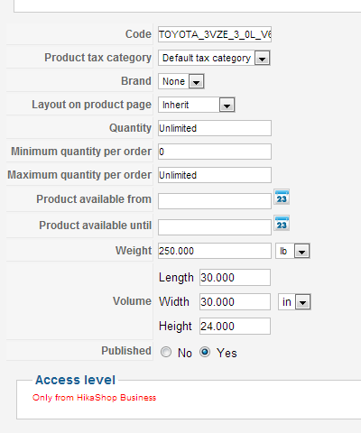

  • Posts: 36
11 years 11 months ago #91157
here ya go
i know it exceeds the max weight, but it gives me that message even though ups is not an option. i just want to turn those messages off.
11 years 11 months ago #91281
The solution would just be to unpublish the UPS shipping method through "Hikashop->System->Shipping methods", because this method isn't available because of your product's weight.
The following user(s) said Thank You: ICwater
