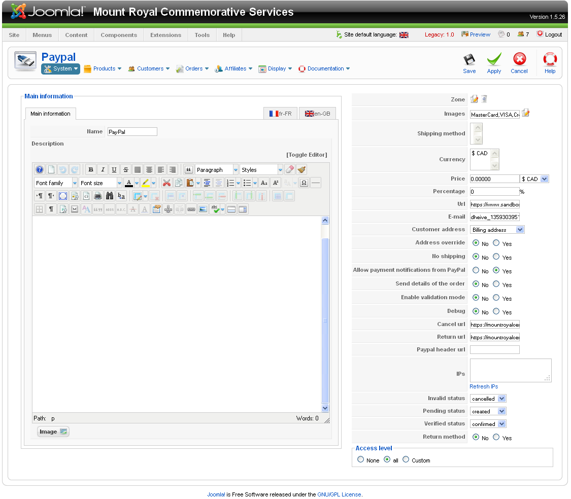

Thanks to check if the option "Enable validation mode" is disabled.
Can you give us a screenshot of you paypal configuration ?

I have checked Enable validation mode mode is disable only..

Can you enable the debug option in this Paypal plugin, and see in the logs if there is an error returned ?
To find the logs, you can go in HikaShop > Config > Main > Files > "Payment log file" and click on "See reports".
