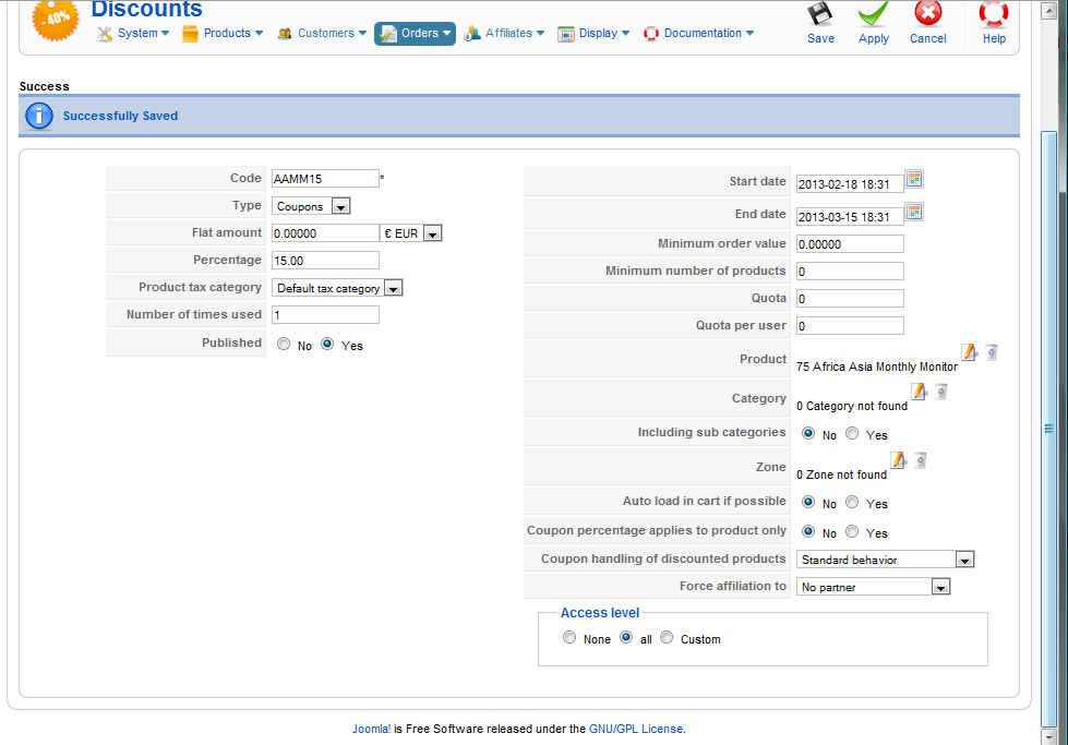

After selecting the bank transfer payment option and entering coupon AAMM15 for product www.consultancyafrica.com/index.php?opti...ep&step=3&Itemid=274 :
a. the first time the screen reloads and the discount is not added
b. the second time the user is redirected to the banking details without displaying the final invoice.
The final emailed invoice doesn't include the coupon discount. The coupon settings:

Regarding coupon issue, I cannot test it on your checkout as I'm getting that error:
Fatal error: Allowed memory size of 36700160 bytes exhausted (tried to allocate 16806 bytes) in /usr/www/users/consulaz/administrator/components/com_hikashop/classes/cart.php on line 1184
Please increase your memory_limit on your server to avoid that issue.

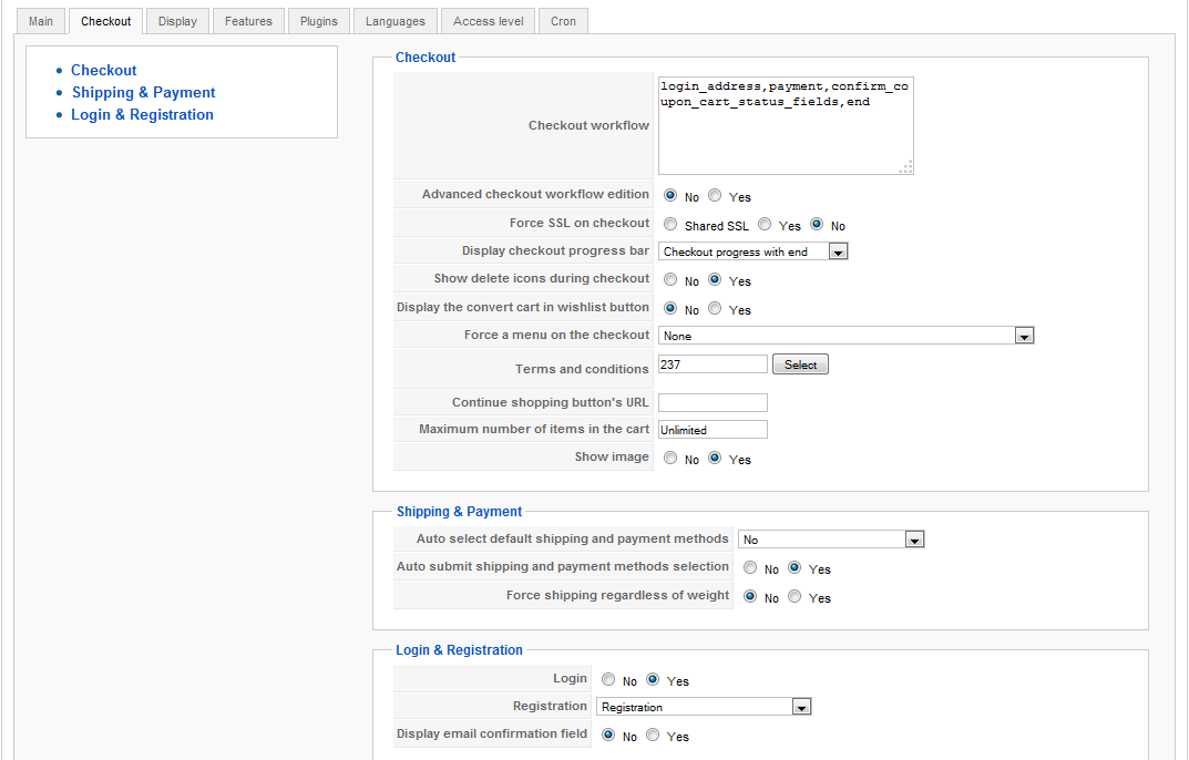

Also a screenshot of the checkout tab of the configuration would help.

  • Posts: 21
11 years 11 months ago #91313
Hi Nicolas
Thanks for your feedback.
1. There is no shipment and the process worked smoothly (except for coupons) before the upgrade. All payment options are configured and enabled. PayPal screenshot attached.
2. I just tried several and got the same error most of the time, but managed to get through to the invoice screen once but was not able to repeat it. The memory_limit is set to 64MB - the maximum allowed by the SP. What else needs to change to resolve the memory allocation issue?
Checkout config screenshot attached.

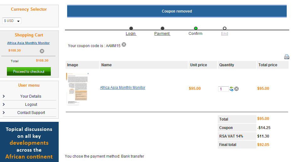

The code has been replaced and I've been able to complete the process to the end screen 3 times. However, the following happens during the process:
1. Step 1 (Confirmation of Billing & Shipping addresses) reloads the same page when clicking on Next. However, there's no problem if the process is cancelled before completing the checkout and restarted during the same login session. Same issue as in the original post.
2. After selecting the bank transfer payment option and entering coupon AAMM15 for product www.consultancyafrica.com/index.php?opti...ep&step=3&Itemid=274 :
a. When the AAMM15 code is added and Add coupon is clicked, the end/final screen displaying banking details is loaded. The emailed invoice doesn't include the coupon.
b. The second time the same product is added the confirmation screen displays the coupon and it's value at the bottom when it loads.
c. Removing the coupon doesn't work.
3. If 2 different products have been added, removing one of these from the confirmation screen displays a "Shopping cart is empty message" and redirects the user to the product category homepage.
The company produces monthly reports and the launch earlier was supposed to market the February report. The next report is going to be launched on 4 March 2013 and I need to get this working by then. Before we discovered the coupon issue and upgraded, all was configured and working. Is there anything else that can be done / tested / checked to speed this up?

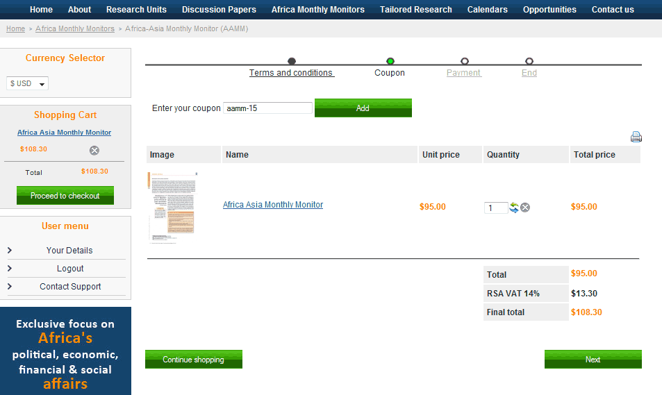

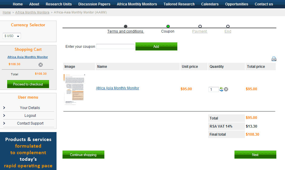

The first issue is on step 12 where clicking on Add (coupon) doesn't add the coupon and the screen reloads. The second issue is on step 29 where Add (coupon) is clicked and the Payment method screen is loaded automatically, without coupon being added or clicking on Next.
Product 1: www.consultancyafrica.com/index.php?opti...yout=show&Itemid=274 (Coupon aamm-15)
Product 2: www.consultancyafrica.com/index.php?opti...yout=show&Itemid=275 (Coupon acmm-15)
TEST 1 - PRODUCT 1:
  1. Open www.consultancyafrica.com/index.php?opti...yout=show&Itemid=274
  2. Click on Add to cart (page reloads)
  3. Click on Proceed to checkout
  4. www.consultancyafrica.com/index.php?opti...=checkout&Itemid=274 page opens
  5. Tick checkbox next to Please accept the terms and conditions before proceeding

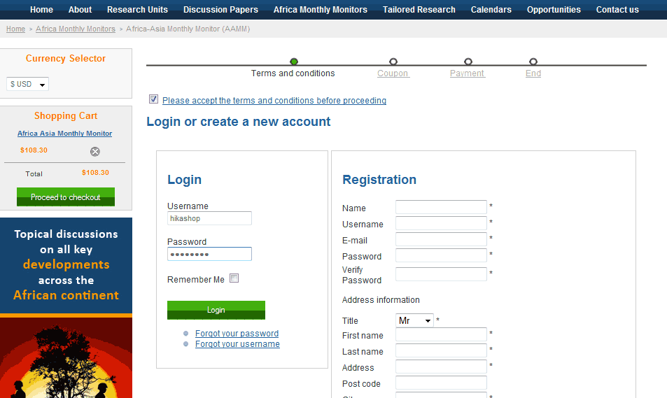

  6. Complete Login section:
  7. Username: hikashop
  8. Password: hikashop
  9. Click on Login

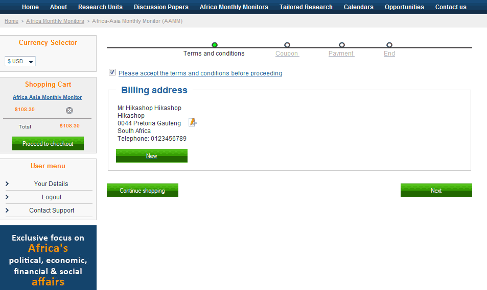

  10. Billing address screen
  11. Click on Next
  13. Enter aamm-15 in Enter your coupon field
  14. Click on Add
  15. Page reloads, no coupon added to total

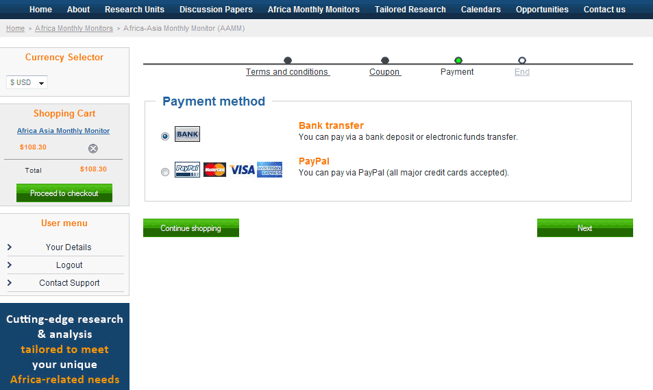

  17. Payment Method screen is displayed ( www.consultancyafrica.com/index.php?opti...ep&step=2&Itemid=274 ) (URL included for cross-referencing only)
  18. Select Bank Transfer
  19. Click on Next
  20. The same screen reloads
  21. Click on Next

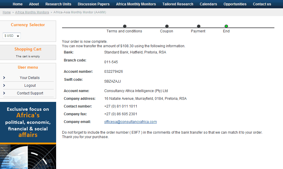

  22. End screen is displayed - Your order is now complete.

  30. Payment Method screen is loaded automatically – Next was not clicked ( www.consultancyafrica.com/index.php?opti...ep&step=2&Itemid=274 )
  31. Select Bank transfer
  32. Click on Next
  33. Payment Method screen is reloaded, Bank transfer already selected ( www.consultancyafrica.com/index.php?opti...ep&step=2&Itemid=274 )
  34. Click Next
  35. End screen is displayed - Your order is now complete.
  36. Logout
  37. Confirmation email doesn’t include coupon discount

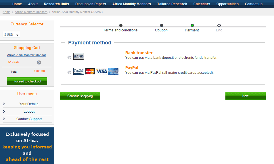

  • Posts: 21
11 years 11 months ago #92479
Additional screenshots

One last thing which needs to be solved is the clicking on the Next button after selecting a payment option - the screen reloads and doesn't take you to the next step. Please note that this also only happens during the first checkout of the session, but not when the process is repeated.
Could you please have a look at that as well and let me know if you need any other info?
  • Posts: 26193
  • Thank you received: 4030
11 years 10 months ago #94507
The first time, there was no payment method selected in your session.
You don't have to "auto submit" option so, the first validation, the payment method is changed and, because the previous method (none) is different than the new one (the selected), the step is not changed.
The next time, there is a payment method selected (en pre-selected) in your session.
If you select the same payment method, it would go on the next step. if you select another, you would stay on the same step.
