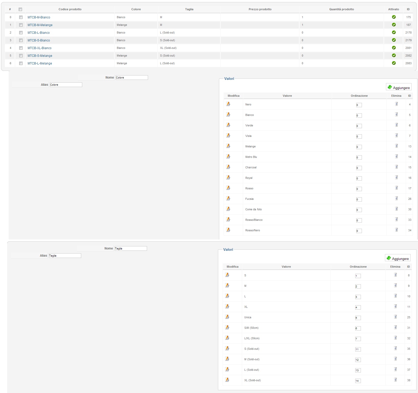

11 years 11 months ago #93642
A link to your product page and some screenshots of your :
- Product's variants listing configuration page
- Characteristics configuration page
would be helpful to understand from where the problem is coming from.

  • Posts: 83378
  • Thank you received: 13486
11 years 11 months ago #93921
On your screenshot of the variants listing, I can see the variant Bianco-XL for the product. So it's normal that you see the XL choice int he characteristic dropdown on the frontend.
I don't see the issue here ?
  • Posts: 84
11 years 11 months ago #93930
Yes you're right.
But you cannot see Melange-XL in the screenshot that you see in the choice in the characteristic.
Do you understand?
  • Posts: 83378
11 years 11 months ago #94154
That's normal. The melange-XL choice cannot be removed from the dropdowns selection. Otherwise, if melange and XL are removed, you won't be able to select the variants using melange, and the variants using XL.
Instead, the system removes the add to cart button for these non existent variants.
Also, if you change the characteristic display method to "table" in the configuration, it will use a 2d table of radios, one per existing variant and that way you won't be able to select non existent variants.

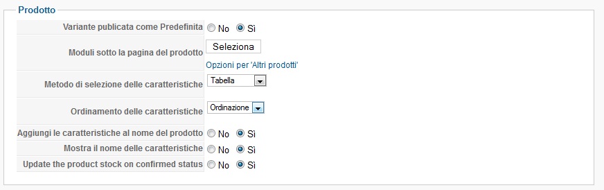

  • Posts: 84
11 years 11 months ago #94180
Sorry, but this is not a solution. My costumer wants this layout, he does not want to change the layout because it works not good.
Otherside, if I follow your suggestion, the behavior is the same as you can see in the link.
You can check the attached image for the option. If I select "table" or "radio" the result is the same: I can choose XL with melange color.
Thank you
  • Posts: 83378
11 years 11 months ago #94215
From what I can see on your product page, that's not the "table" display method of characteristics but the "radio" display method that you're using which works the same as the "dropdown" display method. Please double check that setting.
