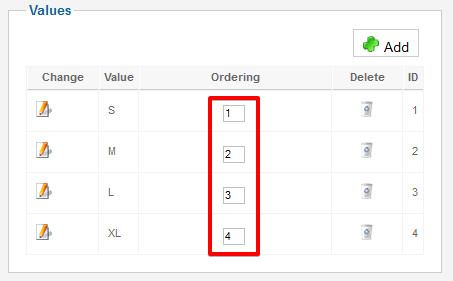

I have a product as option.
in the backend I see the correct order on the dropdown,
but in frontend it is shuffle.
this happens only on this option that has multiple prices,
how can I solve it ?

Have you set an ordering in the characteristic and save it ?

11 years 11 months ago #94510
yes, I had.

Have you set Hikashop > main > product > Characteristics values ordering to ID?

I changed to ID order,
It works, it follow the order, but it is wrong the start of option,
like ordering order as well ( previous picture )
ID order, where '1 colore pantone' is the lowest ID

Please make sure that you're using HikaShop 2.1.1 as we fixed a bug regarding that in that version. If not please update.

11 years 11 months ago #94584
yes !
I updated from 2.0.1 to 2.1.1
It works !
