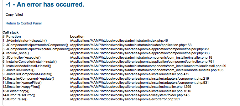

I just tried to update Hikashop essentials to the latest version 2.1.11
I have tried both the .zip and tar.gz files but I just get a copy failed message?
I tried to install another component ( Jevents ) and it worked fine..?
Im working on my local MAMP server...
Any Ideas?

This means that the Joomla installer could not copy all the files of HikaShop because of access rights.
Try renaming the folders components/com_hikashop and administrator/components/com_hikashop before installing again to circumvent the problem.

Tried that but still the same message....
It installs new versions of these folders and it still seems to work but the update/about page says Iam still using version 2.1.0
