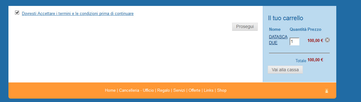

11 years 11 months ago #95213
www.cartashop.com/cartoleria
after this ther is blank page, please see the attachment
the shop in underconstruction, there is a link in the footer

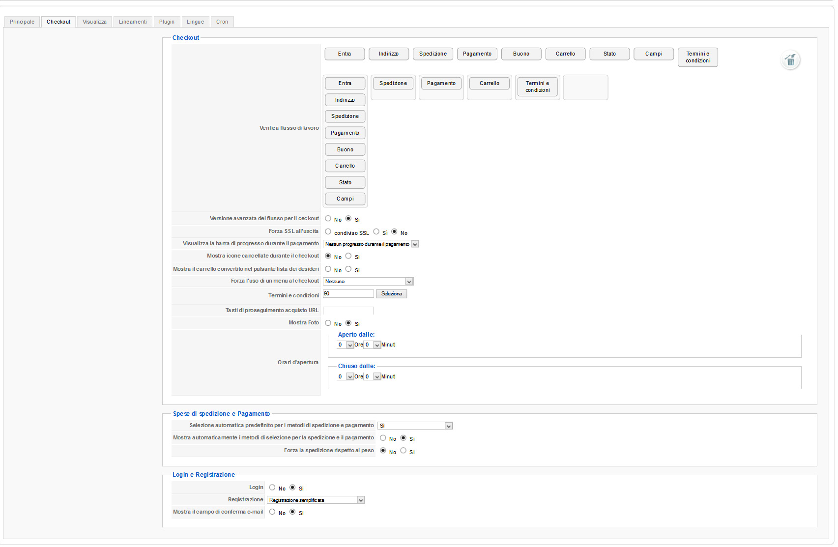

  • Posts: 57
11 years 11 months ago #95225
this is the check out configuration

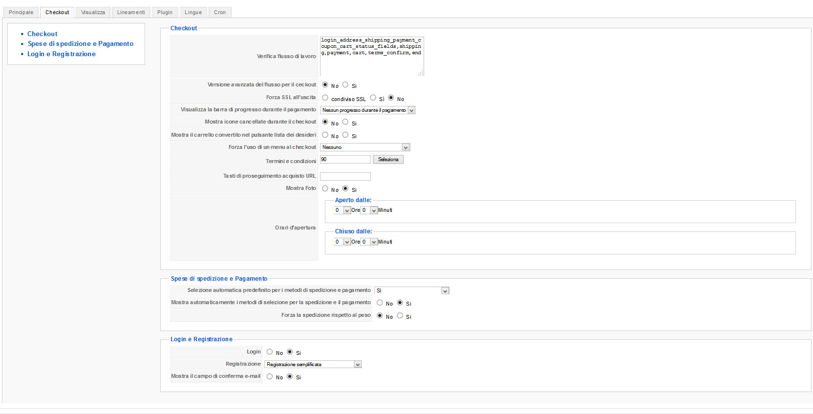

Please turn off the advanced checkout workflow edition interface and copy/paste us the text of the checkout workflow option which appears after that. I guessing that the issue might be that the workflow is not correct.
  • Posts: 57
11 years 11 months ago #95263
I turn off ok, but I don't understand what I must copy and paste
  • Posts: 83378
  • Thank you received: 13486
11 years 11 months ago #95267
The value of the checkout workflow option. You can do a screenshot if you want.
  • Posts: 57
11 years 11 months ago #95284
The debug ??
  • Posts: 83378
11 years 11 months ago #95286
No.
Please do again a screenshot of that page:
www.hikashop.com/media/kunena/attachments/14780/check.jpg

  • Posts: 57
11 years 11 months ago #95291
this
  • Posts: 83378
11 years 11 months ago #95306
Yes. At least everything is configured properly.
