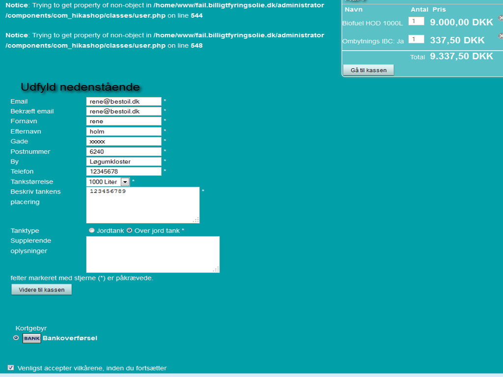

After upgrading today, i have a problem in the checkout
I can't go to further from the site where to insert address..
This is the fails
Notice: Trying to get property of non-object in /home/www/billigtfyringsolie.dk/administrator/components/com_hikashop/classes/user.php on line 544
Notice: Trying to get property of non-object in /home/www/billigtfyringsolie.dk/administrator/components/com_hikashop/classes/user.php on line 548

File Attachment:
File Name: hikashop-error.zip
File Size:526 KB

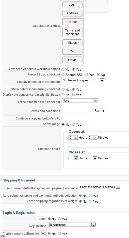

I think I know in which situation the error occurs: My configuration in checkout is workflow "login_address,shipping,payment,confirm_cart_status_fields_terms,end" with no registration, see also the configuration screenprint in the zip-file.
- A customer who has already once done an order will have a record in the database, and cannot register again, see screenprint. No checkout is possible, as he is stopped.
- A new customer can register. In the second screen, shipping, he does get a similar error-message, but this time he is not stopped, and he can proceed to checkout.
I attached screenprints of both situations and of the configuration. Hopefully this clears things up.
Now that I know the error, I realized that my other shop, which I though was upgraded succesfully, does have this problem. If you make an order with email-address This email address is being protected from spambots. You need JavaScript enabled to view it. on martinvanthiel.nl/en/fine-art , you will see the same problem occurrs. Only thing is that error reporting is switched off, but you cannot proceed past the first screen where you have to enter address-details.
Last edit: 11 years 11 months ago by simonkloostra.

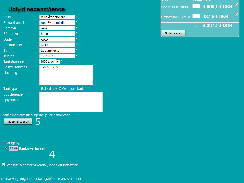

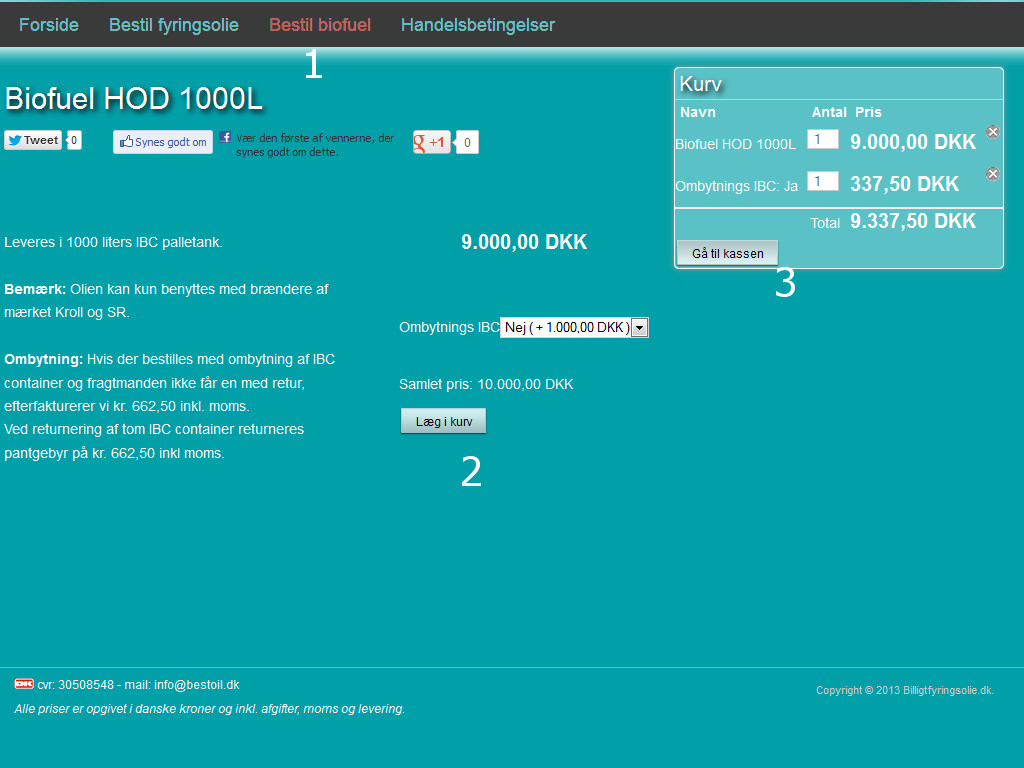

11 years 11 months ago #95480
Here you are..
From frontpage I made the same as you
Here is the way round
Then i check the terms and the bank, after that I go to the checkout (5)
But when i click here nothing happens.. the fails come ( The image is pressed, thats not the screen)
I have tried to unpublish my extra fields, empty the cache both in browser and in backend.
I use J2.5.9 and business 2.1.1
this happend after the upgrade.
My checkout in backend
I got the fail on 2 sites, the one is just a testingsite..
