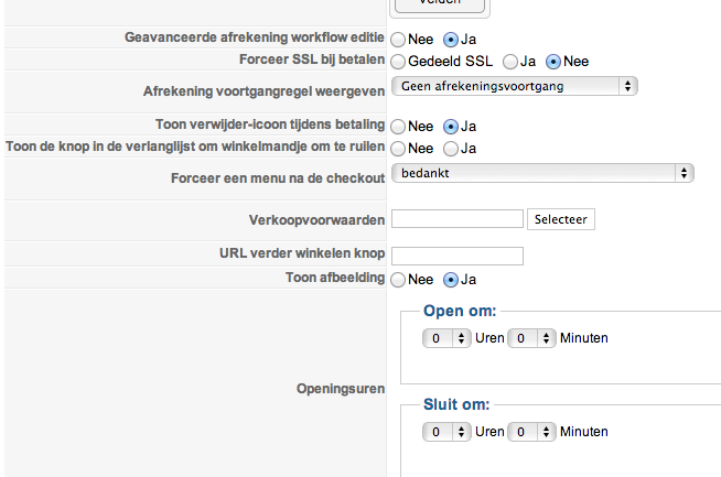

When I set the option, force menu after checkout it does not redirect. It shows the standard thank you file.
Link also remains the same: component/hikashop/checkout/step/step-1?Itemid=298
It points to a 'dummy' / invisible menu that points to an article, both set to public
Bastiaan
Using Hika 2.1.1 / J259 / PHP 5.4

Ok I am probably a bit slow after a long working day but I do not really grab what you are saying or the label is misleading.
In English and Dutch it boths seems to point to a menu choice after the checkout. I don't see a mentioning of modules anywhere.
Please help my tired brains with a good example.

The text of this option is not "force menu after checkout" but "force menu on checkout".
That means that on any page of the checkout, the system will make sure that the current Itemid (id of the menu) is the one selected in that dropdown and not another one. If it's another one, it will redirect to the same page with the correct Itemid.
If you want the system to redirect somewhere else that the default thank you page after the payment, that usually can be done by entering a "return URL" in your payment methods options screen.
