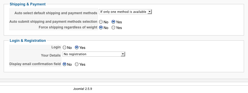

Under configuration/checkout, I have set the Login & Registration with multiple combinations but with no success in rectifying the issue.

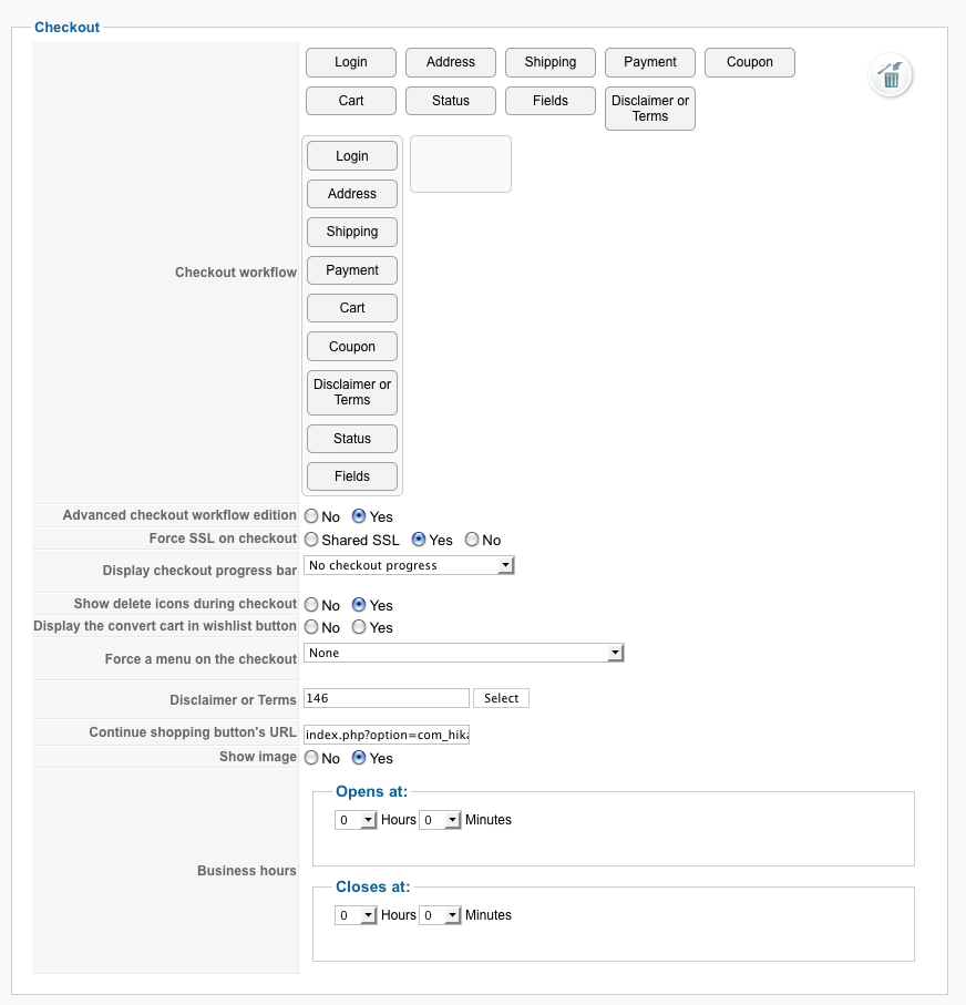

Generally the "next" button is not displayed if there is a shipping method and no address entered.
Could you give us a screenshot of your checkout configuration ?

Presently, when one enters their details and clicks submit, the screen refreshes, Billing & Shipping address do not appear as before, just the same 'Your Details' with entered information remembered.
Then, if you attempt to click a shipping method and/or payment method, the screen refreshes, yet does not accept what you have chosen and the next button still does not appear.
Previously, the Next button was not available until one entered their name, address, etc., then click submit. Once details were entered and submit button clicked, the screen would refresh, and Billing & Shipping address would appear, next button would also appear at this point, but of course, you still must choose a shipping & payment method.
Attached, are screenshots of my checkout configuration.

The problem is that you have configured the checkout "Registration" option to "no registration" and you are trying to checkout with an email already stored in database, so it return an error.
With the Joomla notice, this message would have been displayed.
Try to checkout with a not-registered email, it will work.
