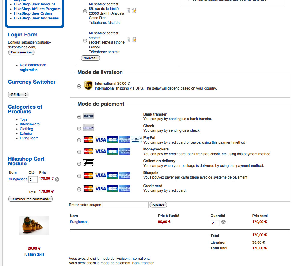

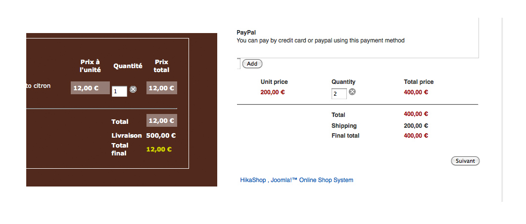

  • Posts: 107
14 years 2 months ago #8063
Screenshot from your demo site :
1 customer 2 adresses ... just playing with both adresses after 2 or 3 changes ... shhiping is not counted anymore !
