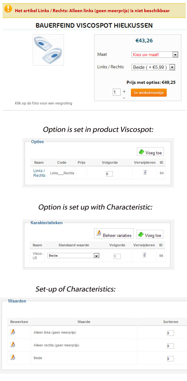

The following problem exists on my site for a while. Problem probably exists for a while already, so may not have been introduced with the latest upgrade. No changes have been made by myself in this product. See hielspoorinfo.nl/webshop/product/40-baue...viscospot-hielkussen for the product in error.
The problem is with a product for which I have set up an option, whith 3 values. The default option has an additional price, the other 2 don't. When customer order the default chosen option, all goes fine. However, when they choose the cheaper option, they get a message that that option is not available.
The base product is put in the basket though, and they can proceed to checkout, but the chosen option is not shown in the order-details, so I have to call the customer to ask them which one is chosen.
I have attached a screenprint of the error, and the way the product is set up.
All quantities are set to Unlimited.

You probably have the option "display add to cart button for free products" turned off in the configuration so the system refuses that you add products without a price to the cart.
  • Posts: 132
11 years 11 months ago #104160
Thanks, that fixed it.
