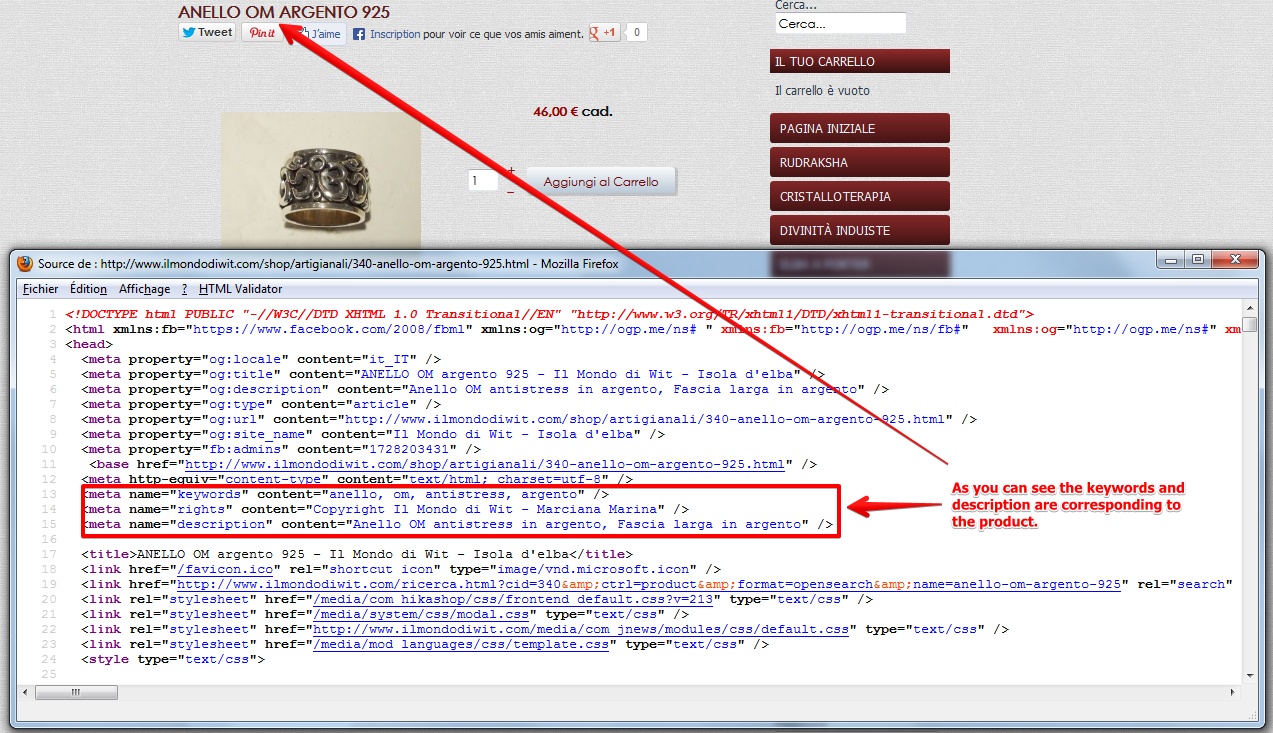

11 years 11 months ago #104337
As you can see on the screenshot, the good metadatas are used for the products:
Last edit: 11 years 11 months ago by Xavier.

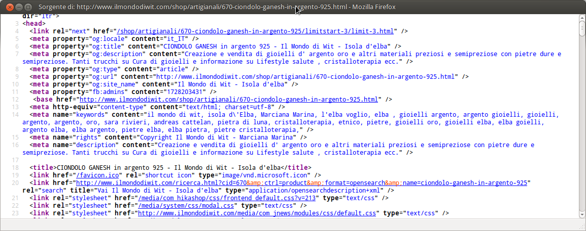

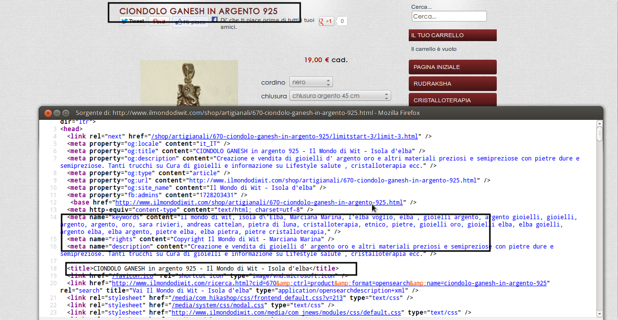

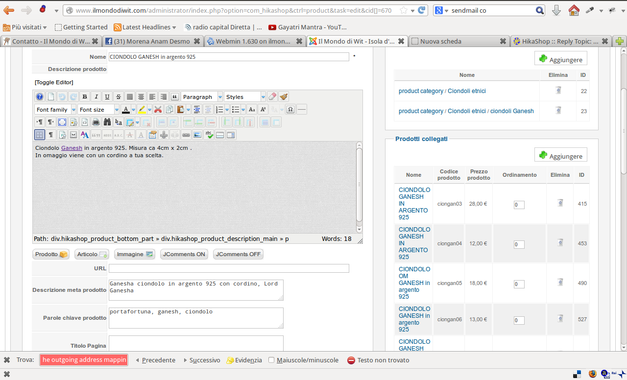

  • Posts: 75
11 years 11 months ago #104785
Ok.
This this one of the products
www.ilmondodiwit.com/shop/artigianali/67...-in-argento-925.html
I attach one screenshot of the backend where you can see the setting of the metadescription and metakeywords
Please let me know if i can supply more information
  • Posts: 75
11 years 11 months ago #104793
Hallo.
I payed no more attention of reproducing.
I insert new product WITHOUT VARIANTS
I save it - and it is ok (the metadatas are showing as excpected the specific product metadata)
I insert Variant.
I save it and reloda the page and the Metadata is changing and gets the Main site metadata.
Please let me know if i can give more help
