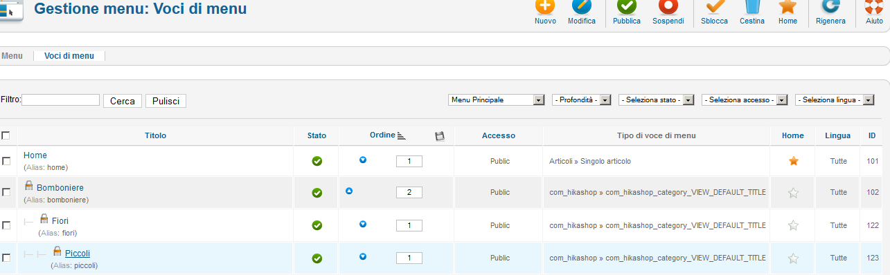

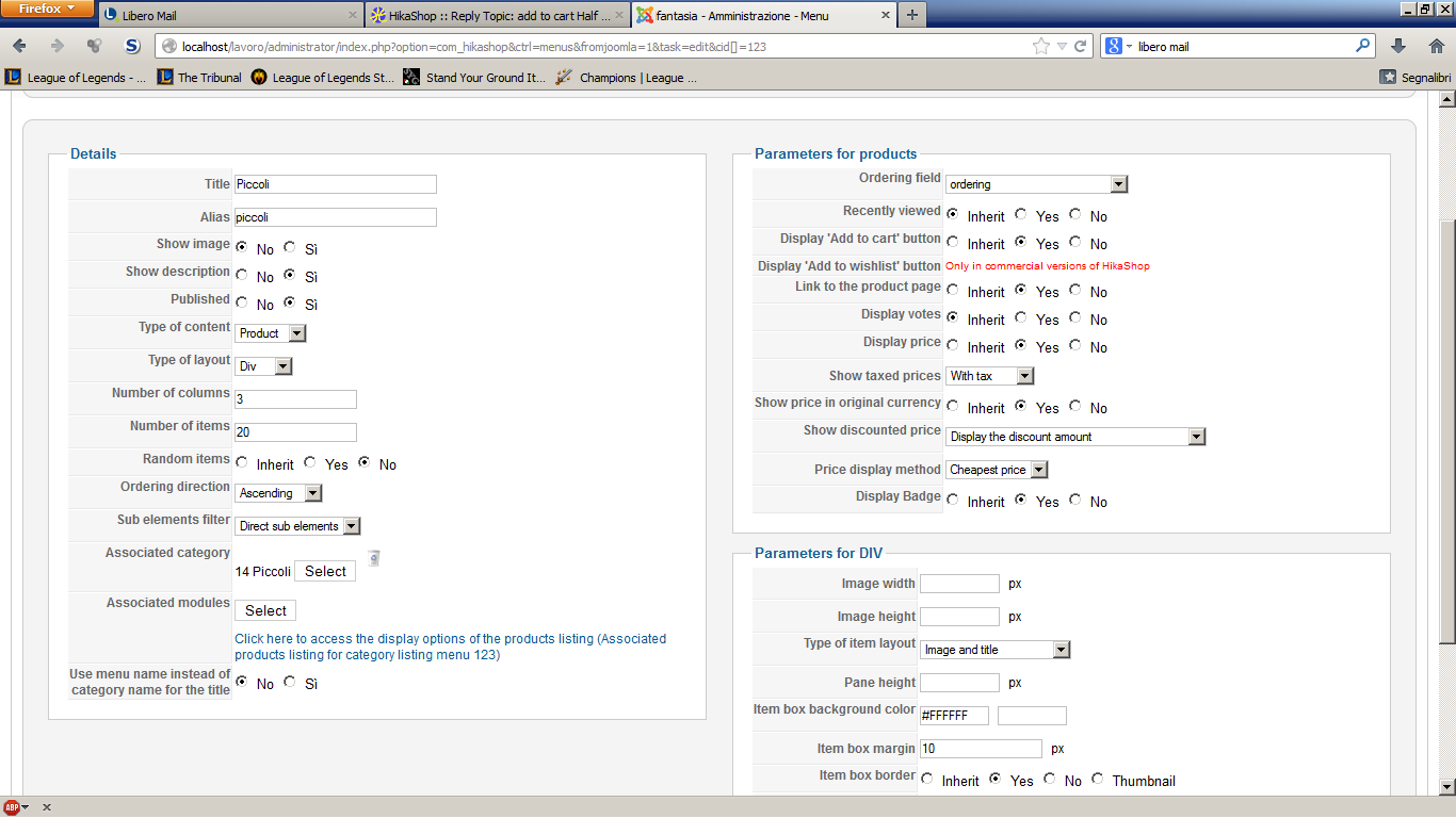

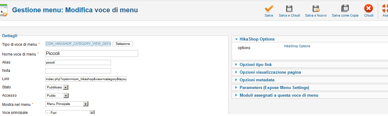

Here some screenshoot. i notice a thing, when i create the menu voice "piccoli" and i chose "product view" type.. when i save, automatly change in category view..
I still don't undrerstand what i misunderstand
12 years 6 months ago #106746
Can you give us a screenshot of the hikashop options of the menu displaying a product listing ?
And if you use a category listing menu, give us the screenshot of the configuration of the associated module.
Thanks to enable the Joomla debug mode, set the error reporting to "maximum" to see if an error is returned when saving the parameters.

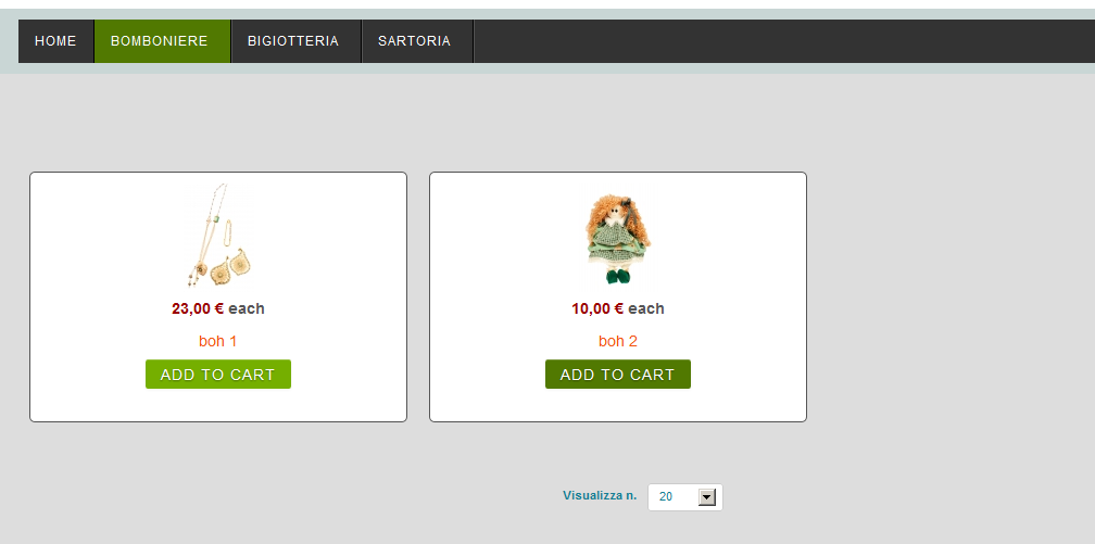

I mean, the Problem is this button in the list of product view. Can I hide the button in this view and let it appear Only when the clic on the specific product?
  • Posts: 84811
  • Thank you received: 13809
12 years 6 months ago #107228
Ah yes, that's easy.
Just turn off the "display add to cart button" option of your products listing menu:
www.hikashop.com/media/kunena/attachments/20474/Immagiane.png

FIne, there's another Problem so... I turned off the cart button... but the cart button is still there.... :S
  • Posts: 84811
12 years 6 months ago #107284
Then you didn't turn it off for the correct module/menu.
Edit them all via the menu Display->Content menus/modules of HikaShop and make sure that the option is turned off for all of them.

I have already turned off the option "show the add to cart button" in piccoli, but really, nothig happend
12 years 6 months ago #107379
If this option doesn't wok it's probably because you have edited the view "product / listing_img_title" and the part with the option has been removed.
Thanks to save the content of this edited view in an external file, then remove the modifications by clicking on the dustbin in the views listing and try again.
