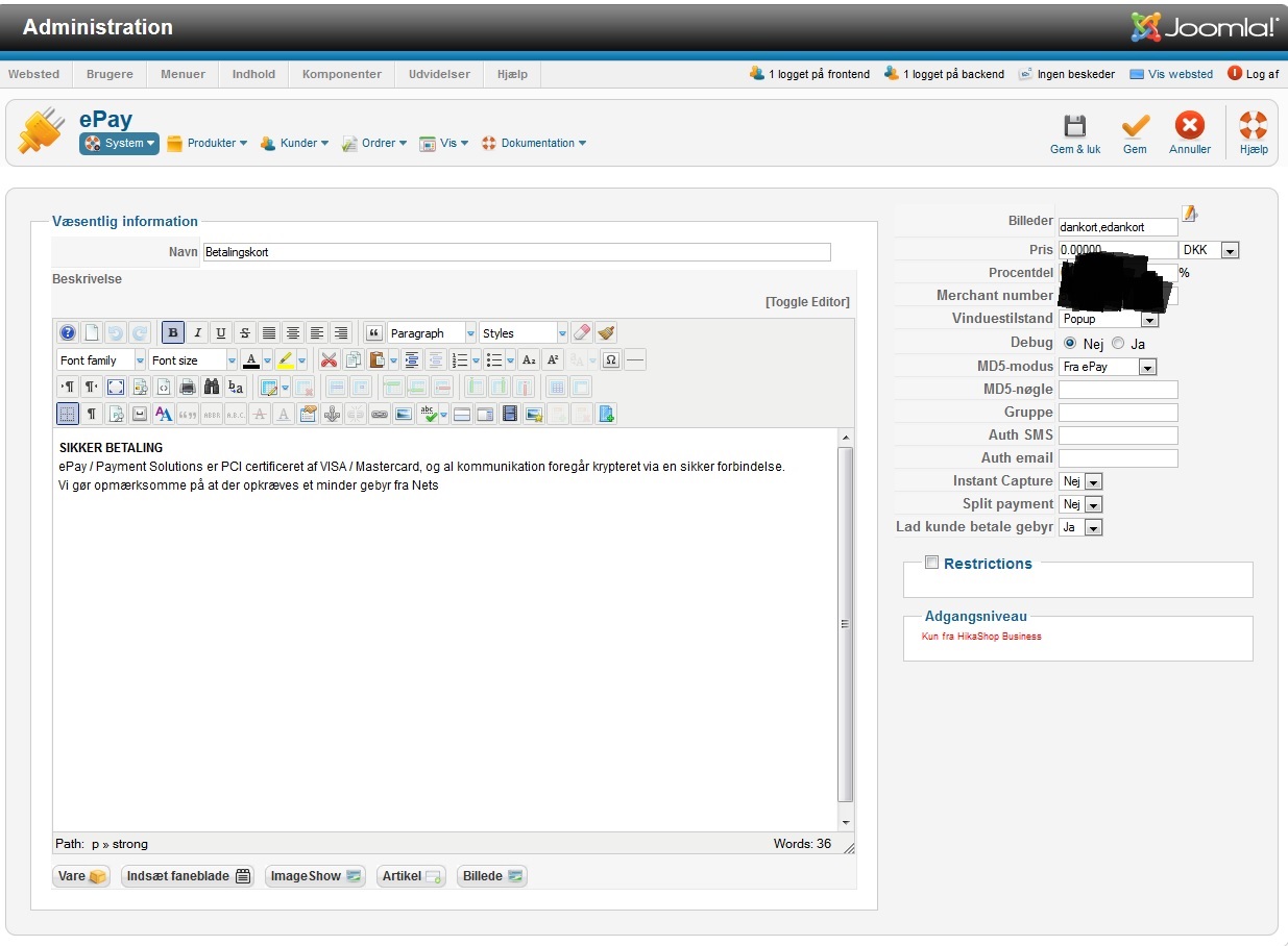

Hi i have this problem to tune off instant capture in the ePay plugin
I hafe add a sceenshot from my settings :)
Still even it is disable in the settings when i run a test then i can see that Instant capture is on her is a log file from ePay:
Merchantnumber=XXXXXX&orderid=52&amount=XXXXXX&currency=208&windowstate=1&
#38;accepturl=http%3A%2F%2Fwww.dcom.dk%2Findex.php%3Foption%3Dcom_hikashop%26ctrl%3Dcheckout%26task%3Dafter_en
d%26order_id%3D52%26Itemid%3D435&declineurl=http%3A%2F%2Fwww.dcom.dk%2Findex.php%3Foption%3Dcom_hikash
op%26ctrl%3Dorder%26task%3Dcancel_order%26order_id%3D52%26Itemid%3D435&callbackurl=http%3A%2F%2Fwww.dc
om.dk%2Findex.php%3Foption%3Dcom_hikashop%26ctrl%3Dcheckout%26task%3Dnotify%26notif_payment%3Depay%26tmpl%3Dco
mponent%26lang%3Dda%26Itemid%3D435&authsms=&authmail=&instantcapture=1&splitpa
yment=1&group=&addfee=0&instantcallback=1&cms=hikashop&_epay_timestamp
=2013651020651

11 years 10 months ago #107806
Can you explain me what your problem exactly is and what do you want to do with the epay payment plugin ?
Thanks :).
  • Posts: 37
11 years 10 months ago #107929
The problem is that I can not draw people's money from their bank account before I sent of their order product.
With Instant capture active, then it well draw people´s money immediately,when people approve trade.
According to eBay support the says that it is the plugin there has a error
It is not permissible according to Danish law :woohoo: to draw people's money from their bank account before I sent of their order product
So how do I turn it off when it when it is already are tune off in the control panel? :huh: (See Sceenshot)
If you see the log file a have put in then you cant see that instantcapture=1 is active
It should be saying instantcapture=0 a then it i tune off
  • Posts: 2334
  • Thank you received: 403
11 years 10 months ago #107976
Indeed this is a strange behavior.
We'll try to look at it but if you want to solve the problem quickly you can edit the payment plugin in plugins/hikashoppayment/epay_configuration.php and replace this line:
<option <?php if($this->element->payment_params->instantcapture == 1) echo "selected=\"selected\""; ?> value="1"><?php echo JText::_( 'HIKASHOP_NO' ); ?></option>
by this one:
<option <?php if($this->element->payment_params->instantcapture == 0) echo "selected=\"selected\""; ?> value="1"><?php echo JText::_( 'HIKASHOP_NO' ); ?></option>
