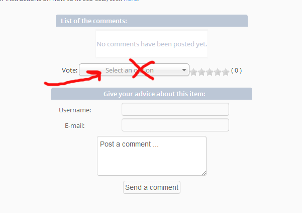

Just updated to the latest version and have now found that there is a drop down box next to the voting stars on my product pages.
Before it was just the stars showing - how to get rid of this - as can't find a setting and it might be a bug
see pic

Could you check the view "vote | mini" ?
You should have the line
<select name="hikashop_vote_rating" class="chzn-done" id="<?php echo $select_id;?>">
If you don't have class=chzn-done", you can add it and test if "chosen" is no more loaded with this drop down.
If it does not solve the problem, you will have to change the option "use chosen" in the HikaShop configuration (tab "display").
We will investigate on this problem.

11 years 9 months ago #114512
There was no class=chzn-done so added the line in and it is all working now

11 years 9 months ago #114516
Just had a look again - it is working where the votes are located at the top of the product page near the photo and product name
but at the bottom of the products where I have the comments and votes, the drop down box problem is still there.
Also, I would prefer to only have the votes at the top of the product - not with the comments.
THere should be 2 options - to have votes with comments or comments only but also to have votes only at the top of the product page
11 years 9 months ago #114538
You can potentially hide the second vote display with some css.
Thanks to give us a link to your website to see from where the problem can come from.
