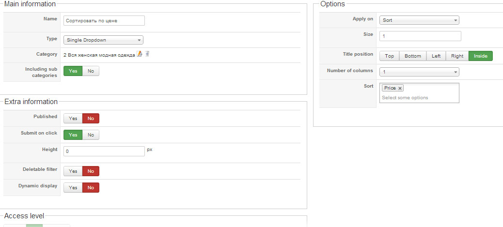

  • Posts: 120
11 years 7 months ago #114790
Ooopph..
You are great guys there! I have localized the issue.
Whatever filter I try to select, it always shows me message Unknown column 'filter_6' in 'order clause'.
Filter with ID 6 is a simple sort by price.
After I have disabled that filter, everything works just fine!
I have created another sort-by-price filter with same settings and I have started to get same errors again.
I believe it is a bug. Please see my filter settings on the screenshot attached hereto.
  • Posts: 83345
  • Thank you received: 13481
11 years 7 months ago #114791
I can't reproduce the issue.
I'll need a backend and FTP access to look at that directly on the website with the problem.
For now, I recommend to simply keep it unpbulished until we can debug it during the weekend once you provide the necessary accesses.
