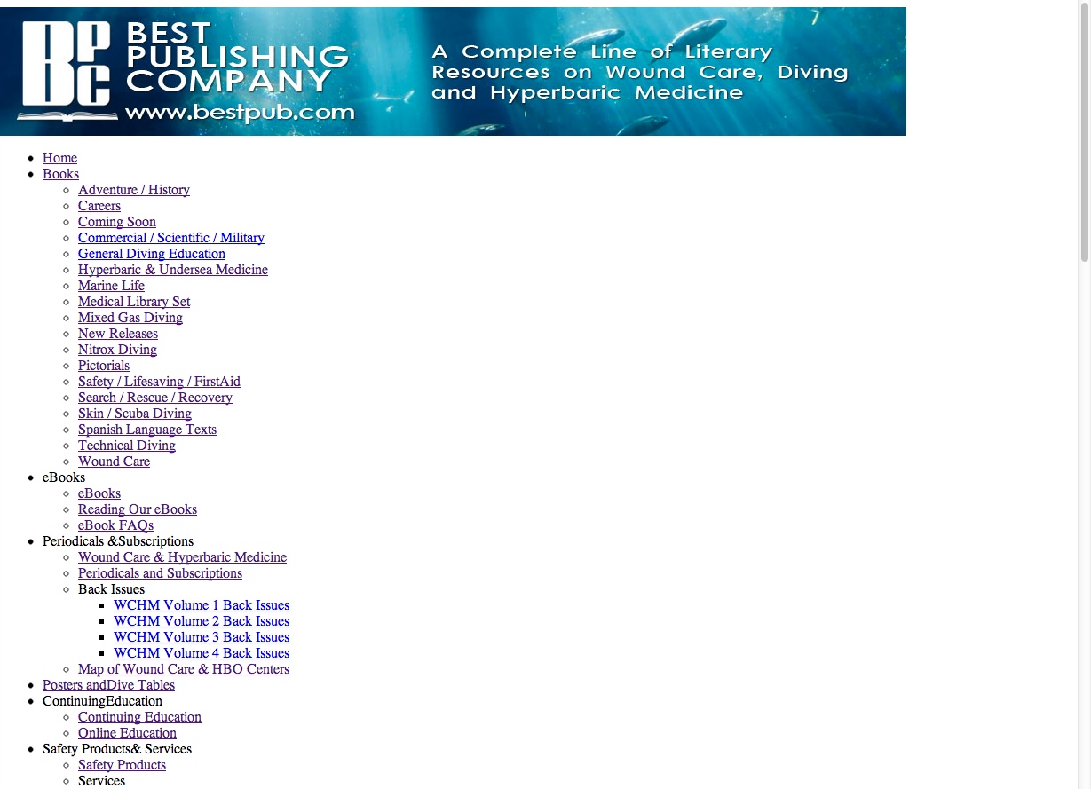

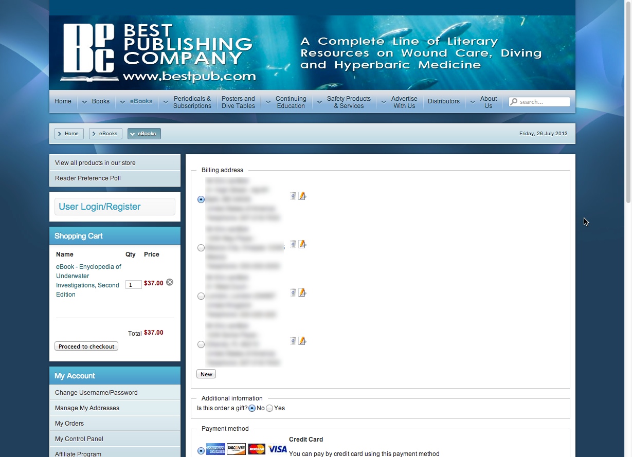

Here are some screen shots. The first one is taken on the checkout page. The second one is taken at the "Thank you" page after I submit the order. Then I am stuck with the layout of the second screen shot until I logout or my session expires.
Any clues?
