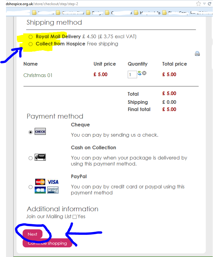

I had my checkout working how i wanted but since updating both joomla 2.5 & Hikashop Business i have a couple of problems...
1/ When you select your chosen shipping method the basket updates and the available payment methods update accordingly (which is what i want) BUT the shipping method radio button does not show selected.
2/ After selecting the shipping & payment i click on the "Next" button to progress order to STATUS but it just refreshes the current page.
I have the latest versions installed com_hikashop_business_2.2.0_2013-07-28 and Joomla 2.5.13
Any ideas?, Kind Regards, Paul.
