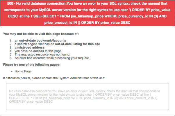

hi it's my first day with Hika, so far i like the concept...and the easy way to touch the design...and so on..and while i am playing with the problems to show the tax in the right way i get this from my DB
No valid database connection:You have an error in your SQL syntax; check the manual that corresponds to your MySQL server version for the right syntax to use near ') ORDER BY price_value DESC' at line 1 SQL=SELECT * FROM jos_hikashop_price WHERE price_currency_id IN (3) AND price_product_id IN () ORDER BY price_value DESC
huiiii...whats happen?

Do you use the latest version of HikaShop ? I recall that there was such problem in a previous version so if you don't have the latest version I would recommend you to update.
If you have the latest version and still have the problem, could you do a screenshot of the full error page ?

Hi, i did the download today...i guess it is the last version...

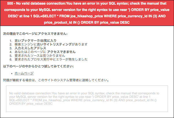

sorry, here is it in english
