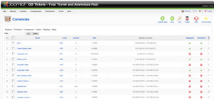

The currency 'displayed' options are enabled (as I said it used to work. I've attached the currency displayed screen to show this.

  • Posts: 83568
  • Thank you received: 13519
14 years 1 month ago #9879
Normally, inside the h2 tag of the product name/code, you should have the name with a span around. However, if I look with firebug (a debug addon for firefox) I don't see the span... I'm really puzzled by that problem.
Same for the currencies. I don't understand the problem.
