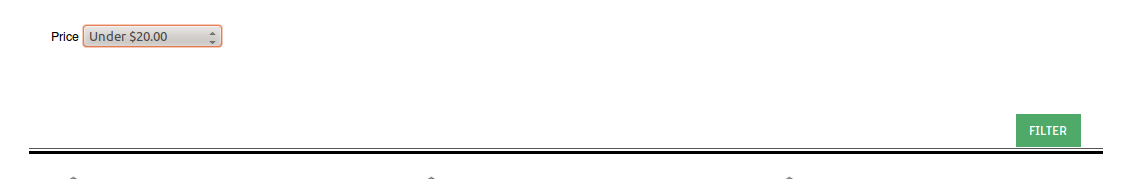

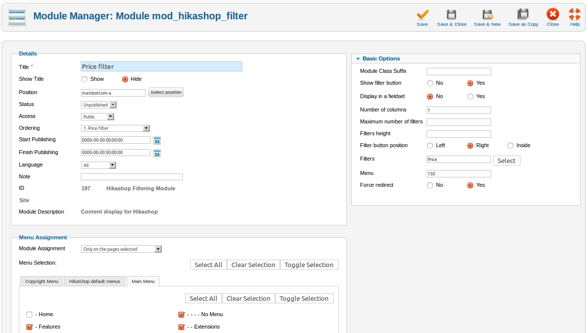

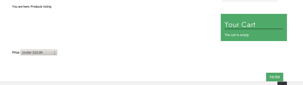

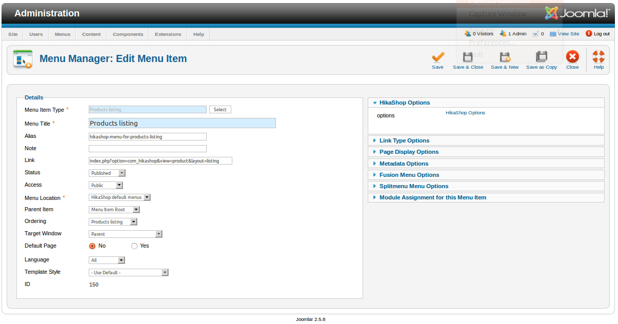

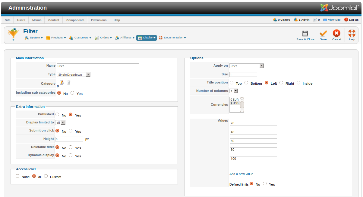

  • Posts: 6
11 years 11 months ago #83193
I got the business edition mostly for the filter and custom product field mostly.
Unfortunately the filter does not work:
1. I created and published the "price" filter.
2. Created the product_listing menu
3. Created and published the module with the menu Id as suggested in the docs.
When I click on filter it gets me to a new (search like) page but with no products displayed.
If I published the created menu and click on it, the products will show on a freshly open browser (Firefox on Ubuntu Linux).
Weird enough though, after I click on the filter (and doesn't give me anything), even if I click on the products_listing menu it doesn't display anything now. I have to re-start the browser in order to get the menu display products. The filter doesn't display anything regardless.
I can't provide you a link to the website yet as the website is still on my Ubuntu/Server machine for development.
Any ideas?
Thanks, Constantin

  • Posts: 6
11 years 10 months ago #83490
Hello Mohamed,
I do not have the site live yet (still on my Ubuntu linux server laptop for development).
But here you are the screens of the setup.
No results as you can see.
