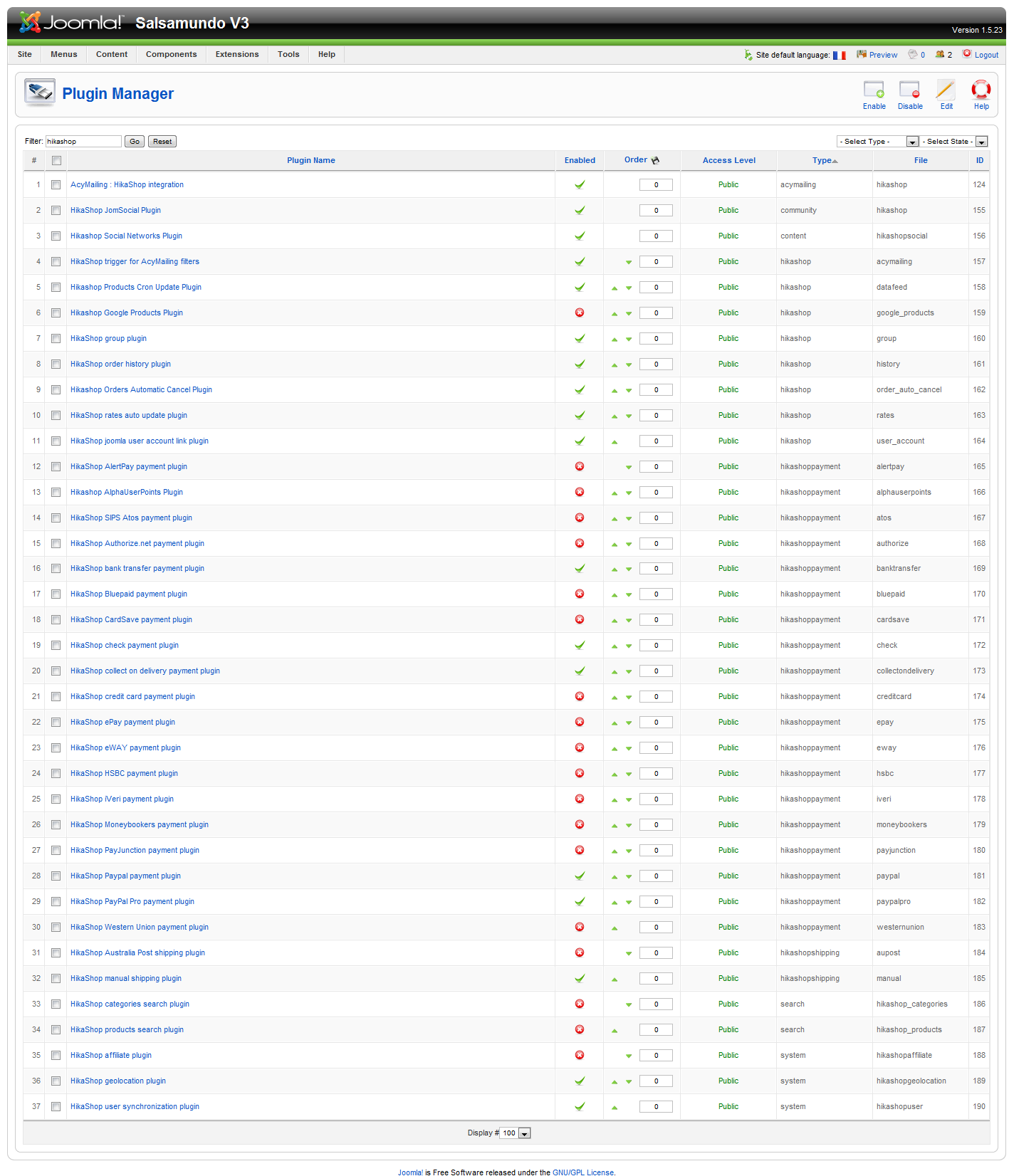

I added screen shots of my hikashop plugins and basic hikashop settings.

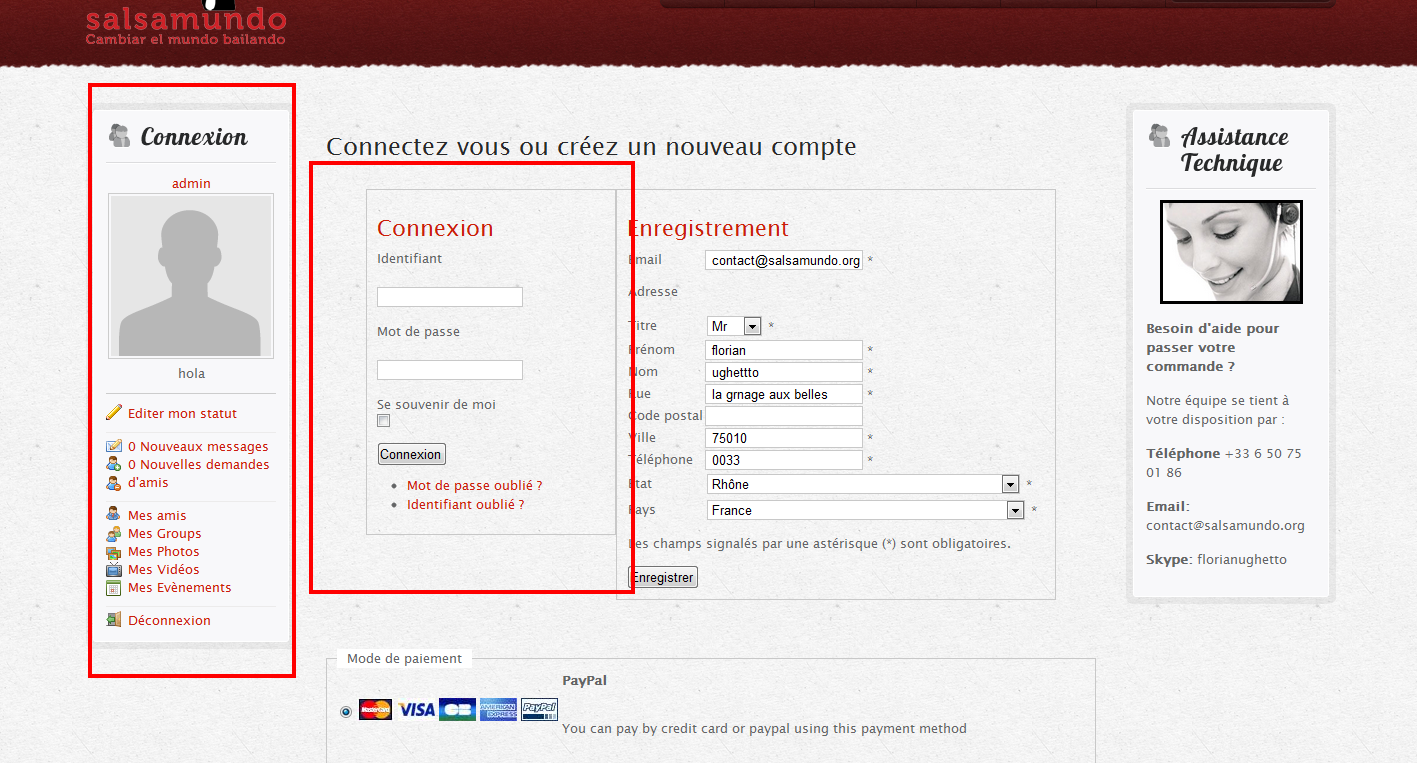

13 years 9 months ago #20590
The issue is still here by the way.
As you can see on the image i'm connected, but canno't connect again to hikashop.

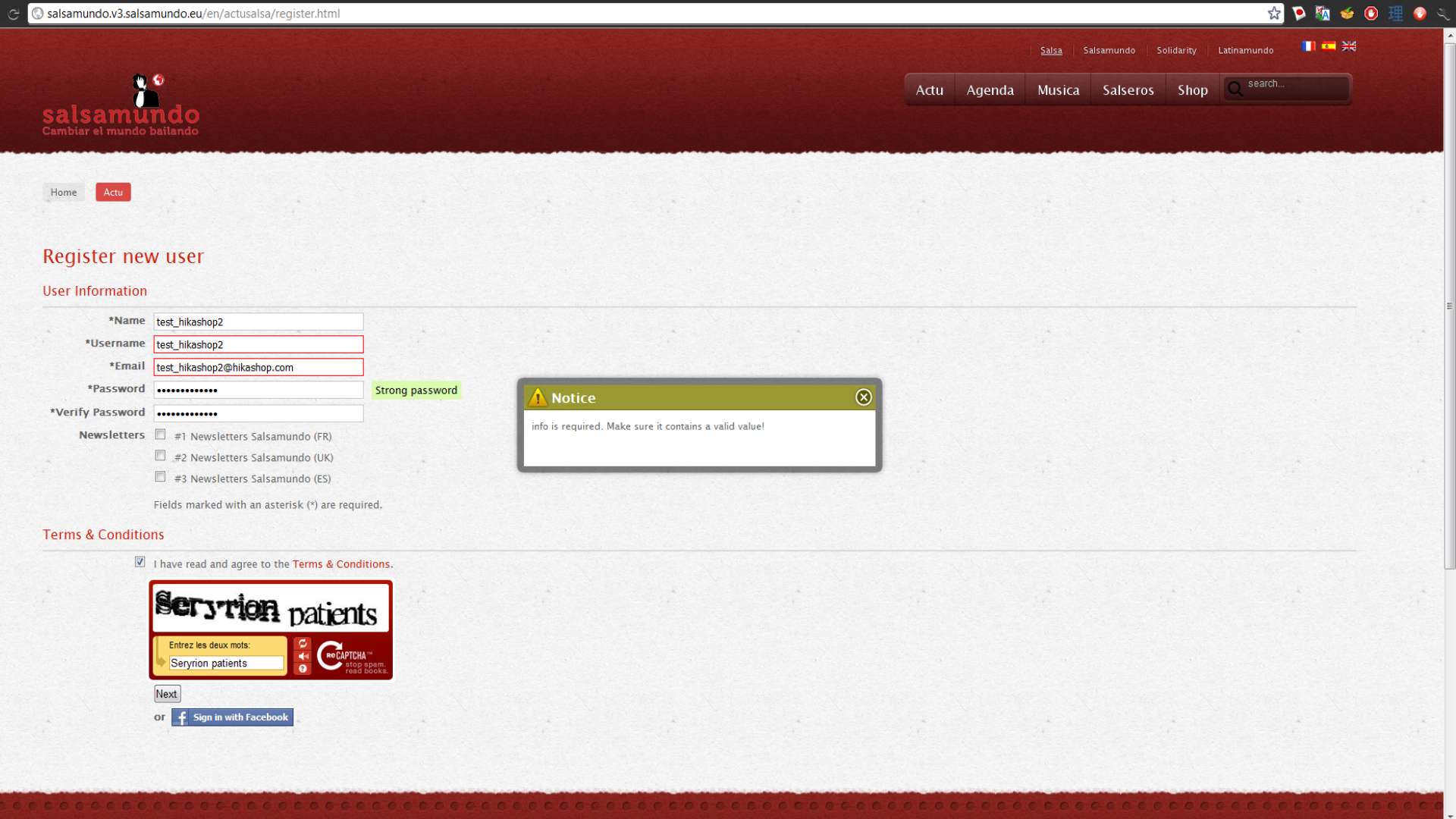

So I tried to register via your registration form but it doesn't work:
  • Posts: 33
13 years 9 months ago #20612
Hello there !
Yes i forgot to tell you than we switched to salsamundo.org (the former salsamundo.v3.salsamundo.org)
I also checked for the registration.
It has to work by now.
