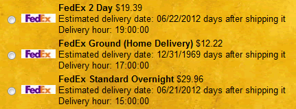

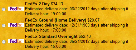

  • Posts: 22
12 years 10 months ago #54682
Mohamed,
The documentation has been emailed to you.
I have tested the plugin and the shipping rates do show up and are lower when the group rate option is selected. :)
A few related/unrelated observations:
  1. If "Show ETA" is selected, the text displayed with the rates is in a strange format (see attachments)
  2. If on the Product page, Ounces are selected as a unit of weight, the rates displayed are really high
  3. If the "Use Box Dimensions" option is selected, the rates are high and also seem to be unaffected by the addition of multiple units
If you are considering adding any features to this, I would love to have the ability to limit shipping options based on transit time. For example, only display shipping options for 2 days or less based on the zone being shipped to.
Thanks for all that you do,
Last edit: 12 years 10 months ago by sammsui.
